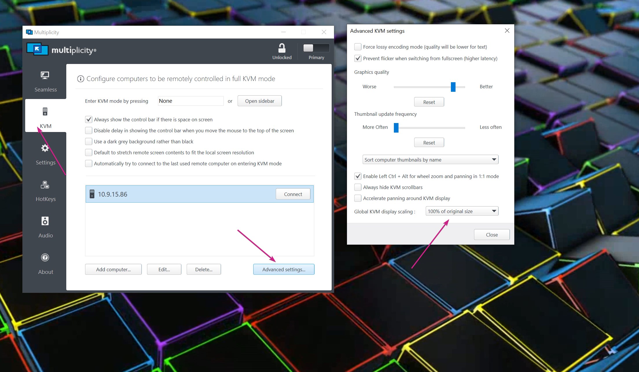

What do you have for this?
Does any change \ reconnect alter your results?
