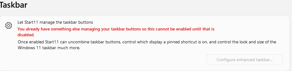

Hi, I purchased Start11 about 2 years ago and have been using it with Windows 11 without any issues, even after upgrading to version 2. Last week, I installed a fresh copy of Windows 11 on my laptop because it was getting slow. After finishing, I installed StartDock V2 and imported my backup settings. Since then, I'm no longer able to change the taskbar behavior; the menu works, but I cannot combine the buttons or hide the labels on the taskbar.
TBH, I don't know if my Windows version is messing with these. Already tried to fix with this:https://www.elevenforum.com/t/always-or-never-combine-taskbar-buttons-and-hide-labels-in-windows-11.15135/windows version

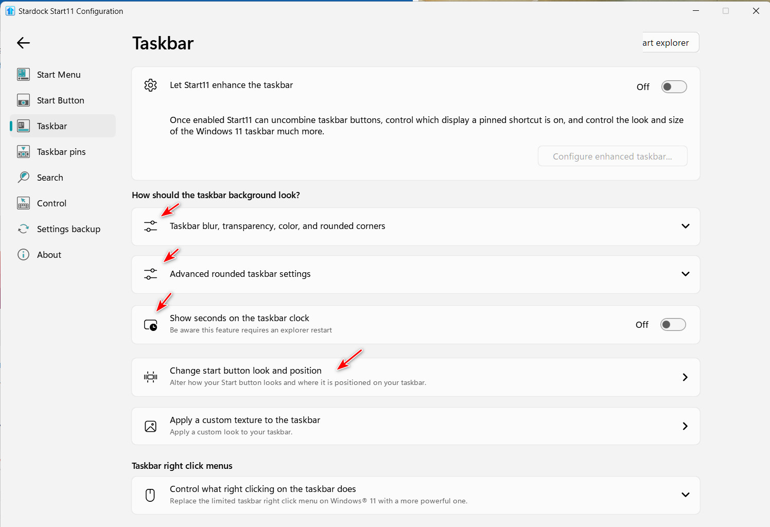

What version of Start11 do you have installed? Your screenshots don't look like the latest version. The icons in the config app are different from 2.07, and the "Change start button look and position" is also different.

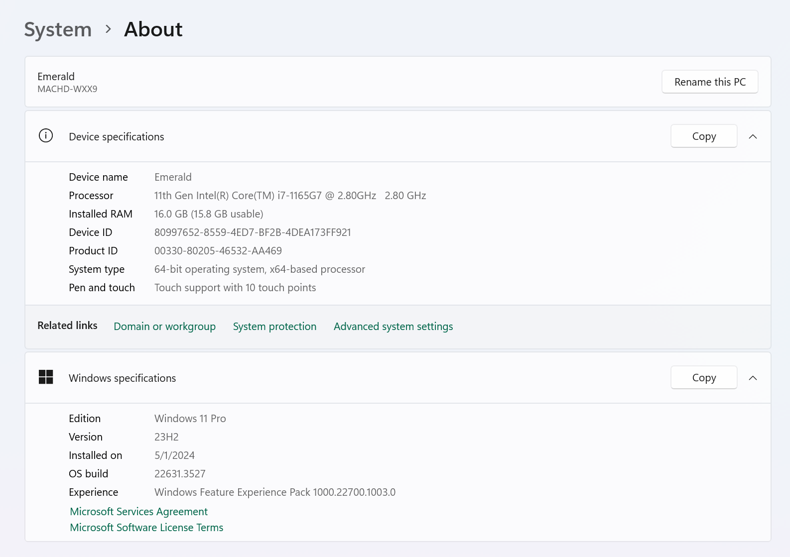

You said you installed a fresh copy of Windows 11 on your laptop, but as Basj says above, your taskbar looks like a Windows 10 taskbar. Something is altering the taskbar other than Windows 11 or Start11v2.

 I've gone back thru my old screenshots of Start11 and the icons on the your Start11 config app image in your above post and the layout of the settings are the ones used in Start11 ver. 1.

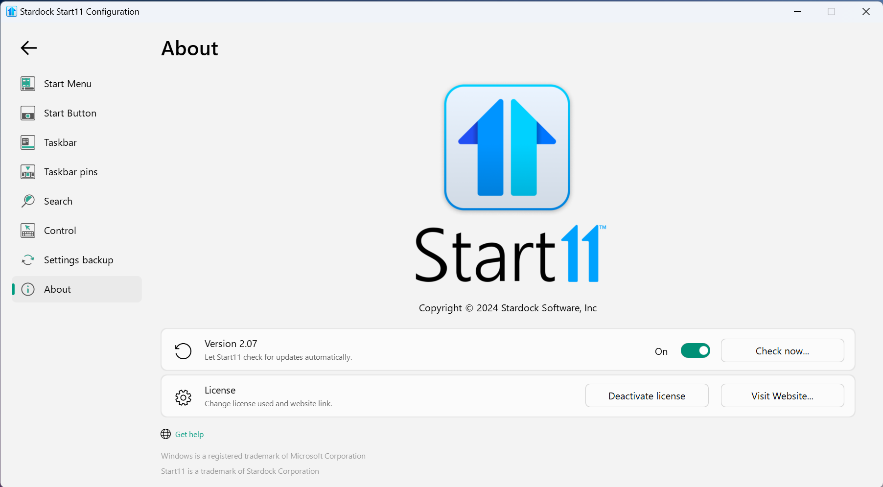

Explain to me why the OP's Start11 config app is for Start11v1 and the About page shows 2.07. There is obviously something wrong here. Evidently the purge didn't work, or he applied the same backup again.

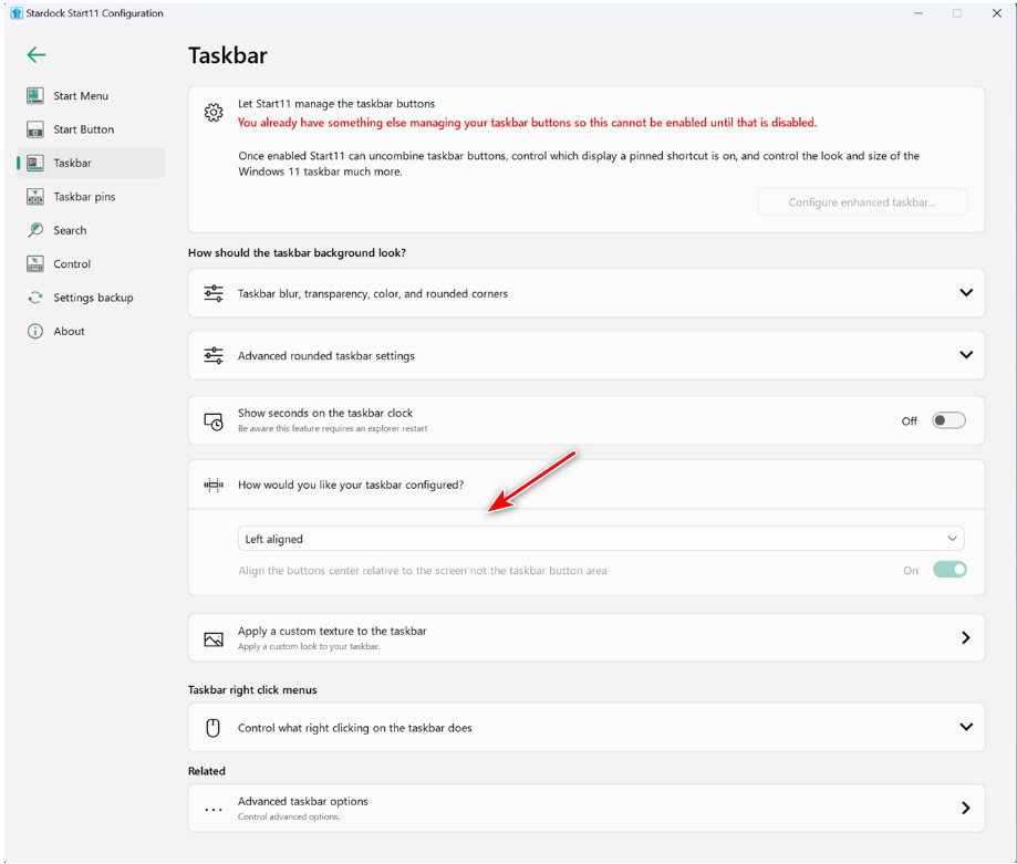

The icons are based on the OS fonts available.  If Start11 detects a win10 taskbar (or thinks it does), it will use the Win10 font hence the icon differences.

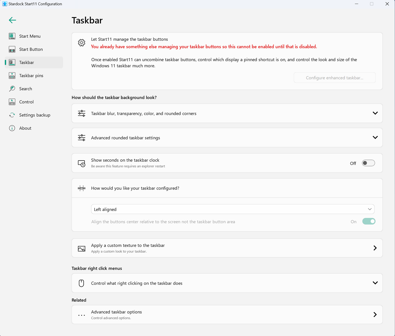

I understand, but look at the screenshot of the OP's config app and the "How would you like your taskbar configured?" section. This doesn't appear to be the 2.07 config app.
Also, the OP said they did a fresh install of Windows 11.

It does when it thinks you are on Win10
