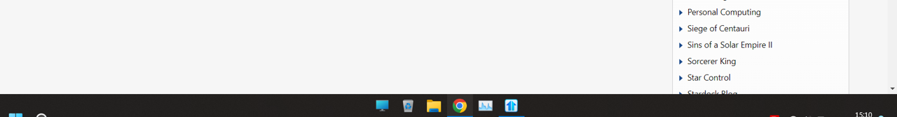

Start Icon and other buttons are not loading correctly
When I turn on my lap top, the windows menu don't load correctly. Some buttons and options are not ok.
I have to "restart the explorer" manually to works fine.
My laptop is a lenovo X1 gen 9, and my resolution is 1900x1200 (recomended)
