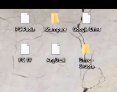

i think I have an issue that causes my fences to crash.
When does it happen? Every time I use a specific rolling up fence and only the first time after my computer restarts. No matter how long I wait after the restart: always (and only) the first time.
Here attached you have a video that shows you what happens: Link to the video here
Second 5: I try to roll down the first fence and this cause the system to be stuck for a while.
If I click somewhere, the system crashes in a more visible manner (sec. 27). After the crash, Fences reloads (second 31).
If I try to pen it again, same issue (second 34 to 58).
And once more (second 60 to 98).
Let me try with the other fence. It works correctly (second 99 to 107).
Let me try again with the first one… It is stuck again but, this time I don’t try to click de mouse. After a couple of seconds (20, more or less), the fence rolls down, finally (second 107 to the end).
From now on, the fence will work correctly, till the next pc restart.

Sorry to hear you are having issues. Looking at the icons inside that Crashing Fence, I believe, it at least one of it link to network Drive i.e Google Drive. Try this guide. In your case just do it for these few shortcut icons: https://forums.stardock.com/514583/get;3875625. Try it and report back. My bet is on those 4 white icons. Fences has trouble getting to it hence the white default file icon.
