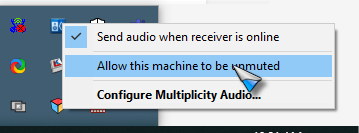

No, in this case the Secondary is actually the Sender, sending audio to the Receiver Primary which is a stationary desktop computer.
I just tried to set "Allow this machine to be unmuted" on the Sender (Surface Go 3) and thus far that seemed to have resolved the issue when Surface is on battery. I can also mute the audio on the Sender and it still hasn't cut out yet.
I will try it some more to make sure it doesn't cut out. Thanks!

The reason for unmuting the sender is to make Window believe it's actually using the hardware it's (normally not) sending to - a power-saving 'feature'.

Hi Sean,
Ah, that does make sense.
Thank you for the help, I haven't had a single issue with random disconnects since!
