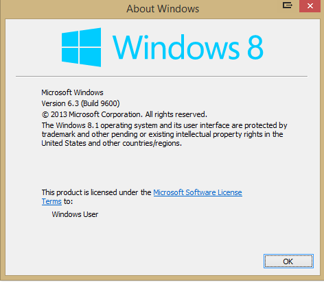

What version of Windows (winver.exe) - post the screenshot of that, please.

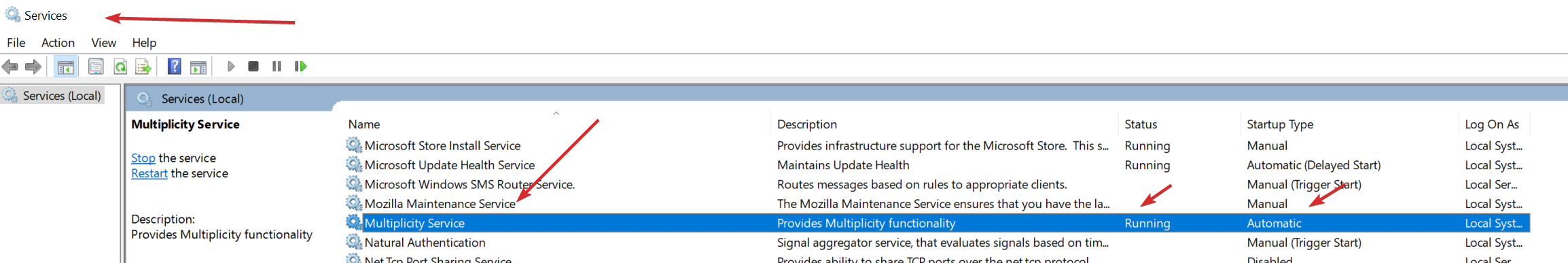

Is the Multiplicity Service running?
If it is not running, right-click to start it.  If it is, proceed...

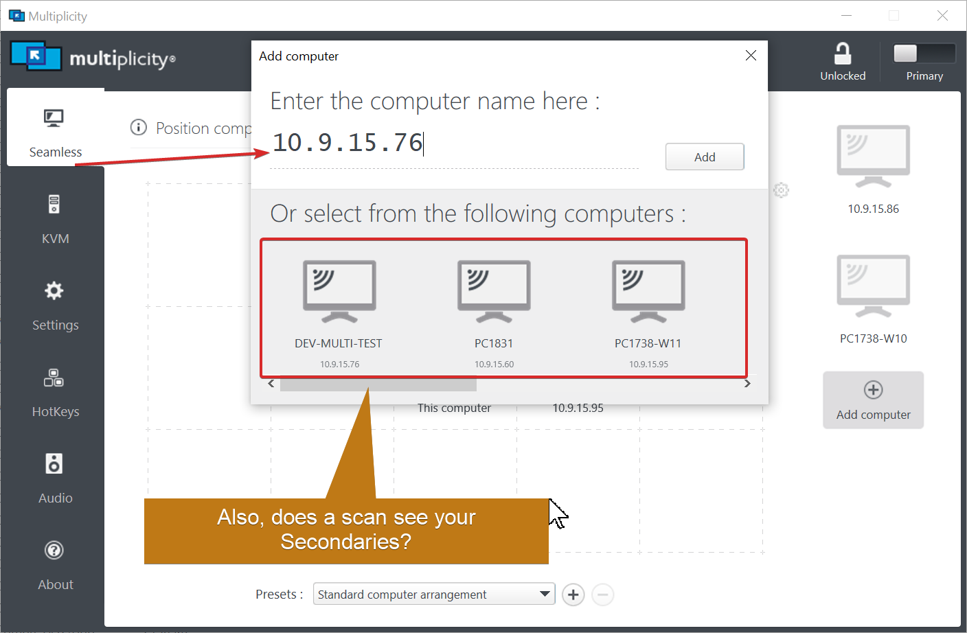

'Disconnected' only means it is not connected to any of the Secondaries.  What happens when you remove them (the Secondaries) and re-add them by IP, example:

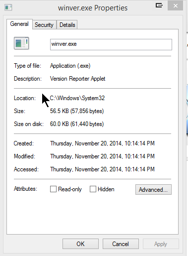

1- screenshot attachedwinver.exe

3- Service is running

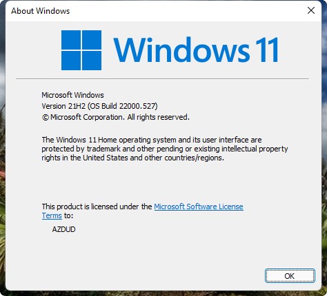

Your version of windows will look like this . Type in winver.exe in run
Please post your version - what you posted is not right .

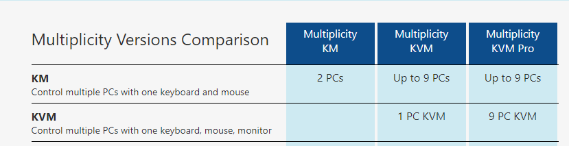

AzDude sending you this is relevant:
https://www.stardock.com/products/multiplicity/#comparison
Your Multiplicity 3 KVM purchase allows for:
1 Primary PC (the controller) and up to 8 Seamless PC and 1 concurrent KVM (remote) connection.
KVM Pro would allow for the same Seamless count but up to 8 concurrent KVM connections as well.
What is constant for all of them is that there is only 1 'license' for a Primary.  If you need more than 1 Primary per license, there is a corp 'single key \ multiple activation' option.
