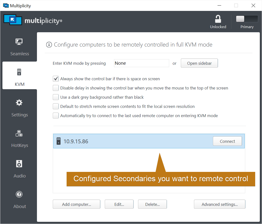

When I go to it (Secondary) and select KVM, there is the 'Connect' button with the Old Primary PC name beside it.  Anyway, if what you advise is correct, then when I click connect...it should find and connect to the primary irrespective of whether the primary's name has changed.
So, I clicked 'Connect' button (via the secondary KVM Multiplicity Control panel), and the result I get is a new window that says:
'Unable to connect to  xxx' (xxx being the old Primary Name).  followed by: 'Connection failed due to the passcode being incorrect'
Back to the Edit KVM and the Old Primary Name is displayed for edit along with the original Passcode.
So, I have now changed the Primary PC Name to the new name on the Secondary PC Multiplicity Control Panel, and kept the old Passcode, but same result... initially.  Then after each try I no longer got Passcode error, just:
Then it was followed by notice:
'The computer is either being blocked by a firewall, offline, configured as a primary, or has KVM mode disabled'.

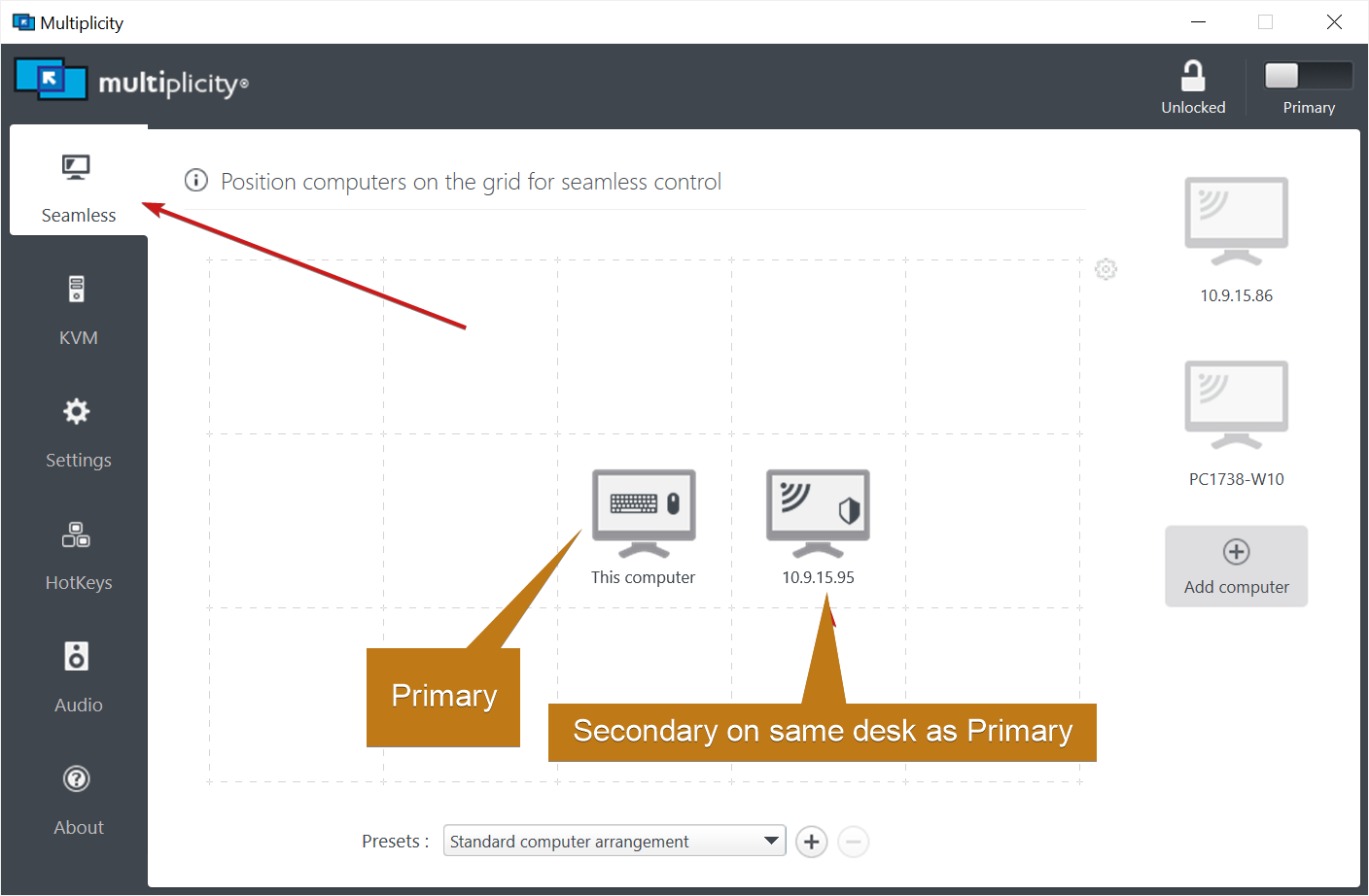

There is nothing in MP where one could connect to a Primary so this may be a semantic issue.
Fist, I want to establish terms:
Seamless: You can see both PCs and want to the Primary PCs mouse\keybord on connected Secondaries configured on this menu:
KVM (Remote connection): Remote PCs, generally ones in other rooms, headless (no monitor), etc:
Since you mentioned KVM multiple times, I'll assume its the latter.
