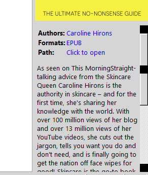

Hello everyone! I've been using this WindowBlinds skin call The Windows Classic Theme by SemoB for quite a while and I really like it: https://www.wincustomize.com/explore/windowblinds/9233/
But I see a problem is that some of my software like SpeedCrunch or Calibre (and a lot more) have this issue that there are black boxes like these:
instead of regular scroll bar buttons like these:
I noticed that some software has this problem and some doesn't. Could you guys tell me why this happens and how to fix this issue? Thank you!

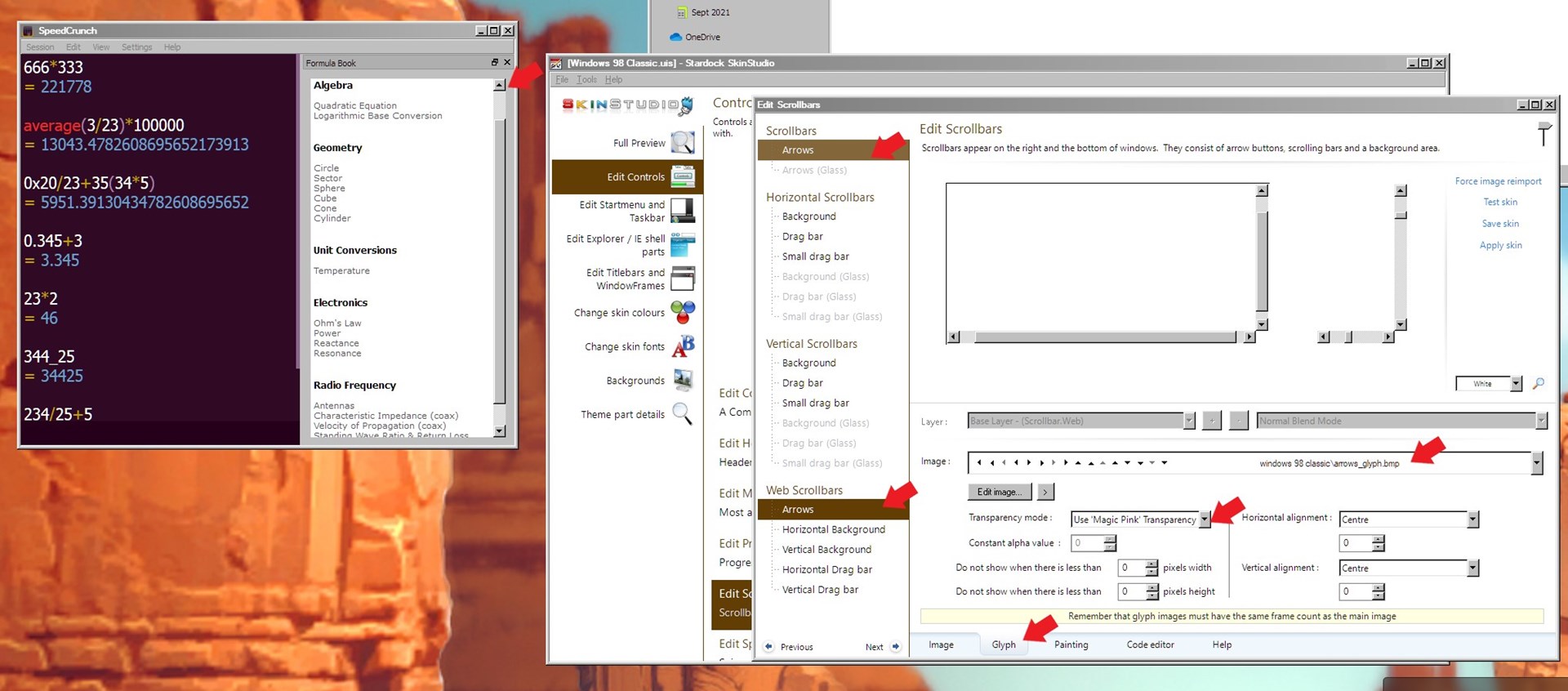

Sorry to hear you are having issues. There is a mistake in that skin. So, you might need to contact the skin author to repair it. Or you can do it yourself if you know how to do it. Via Skinstudios. Change the tga file to bmp with magic pink background.
Hi! Thanks for your response!
It looks like the author of the skin hasn't updated or commented for a while so I decided to fix it myself.
However, I don't know how to change it to bmp like how you did and when I do (I use Make copy of file to make a .bmp, later on I saved a new BMP file in photoshop), it shows a arrows_glyph.bmp file that is surrounded by black background like this and applying this file made all the scrollbar button black also.
I still couldn't fix the problem, please help. Thanks!
You will need to use program like Adobe Fireworks or Adobe Photoshop or something similar. Here steps you need to do.
  1. Open that "arrows_glaph.tga.tga" in any capable graphics program. (need layers capable)
  2. Creat a rectangle pink "255.0.255" as big as the picture.
  3. Send that layer to the back most layer.
  4. Save it under different name and under bmp format.
  5. Import that file into skinstudio.
  6. Save and apply.
If done correctly. It should be something like below.
