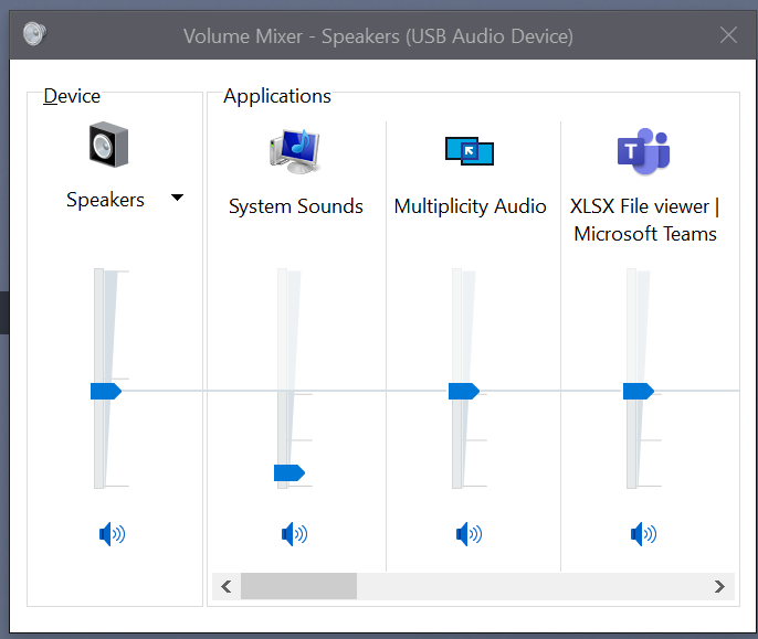

1] Whenever Multiplicity starts, it's at 100% volume in windows.
After setting MP below the max default sound, reboot, it remained the same for me:

1] Sound Level:
I have tried changing the volume and restarting my PC on 5 different machines. It has never saved the value. Is there something I'm missing? Have asked friends to try as well and they aren't able to save it either.
I have even reformatted one of the machines to check and only installed multiplicity on it, left windows completely default, it still doesn't save the sound level. Please let me know how you were able to save it so I may replicated it.

Seems I was mistaken about the volume thing, it is reset with each reboot but I don't know how MP would contribute to that...
Ill get with the lead dev on it.

We have also been able to make it save the level and mute status.  The issue is Windows doesn't save it for the process because it runs on the winlogon desktop so we have to manually do it ourselves.

No I mean we were able to.  We have added manual save code to our code rather than letting the OS remember as it seems it simply can't handle this edge case.
