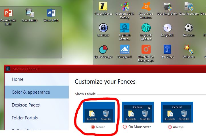

Can you check if you might have unintentionally select the labels to never show option.
Thank you, Basj. I checked that and I had not checked never show labels. Somewhere on the 'net a person had suggested that not having the segoe ui font as the default operating system font might affect Fences. Is that a possibility? I changed the system default font last week. Maybe that disturbed something?
