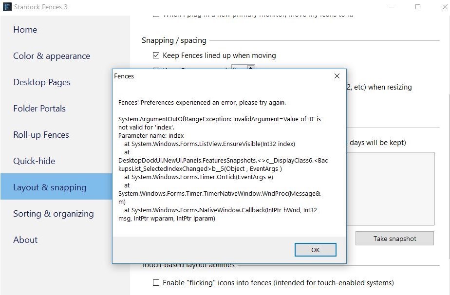

I have tried again to take a snapshot of fences and this time I got an error as seen in the attachment.
Can anyone suggest what all this means and if it may point to what is causing the problem?
Thanks.
Snapshot error

No luck with that :thumbsdown:   something else I have noticed is that both the pc's with the problem are Acer pc's, whereas on Dell and HP computers it works fine.  So maybe something in the Acer software is preventing the snapshot from being saved??  So perhaps it can't be solved unless that error message can be deciphered.
Will just have to hope I don't need to restore my layout one day.
