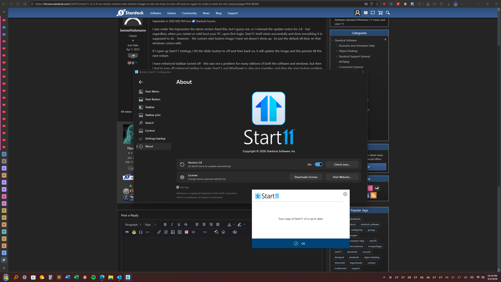

You read it right. The 2.8 changelog does carry "Fix for Start button when Enhanced Taskbar is not enabled", so that path was worked on in this release. What you are hitting is a case that survived the fix rather than something nobody looked at.
Worth confirming the build first. 2.8 shipped as UI version 2.8 with file version 2.8.0.2.

I am using whatever the latest version is (shows 2.8, asking for an update says I need none):
