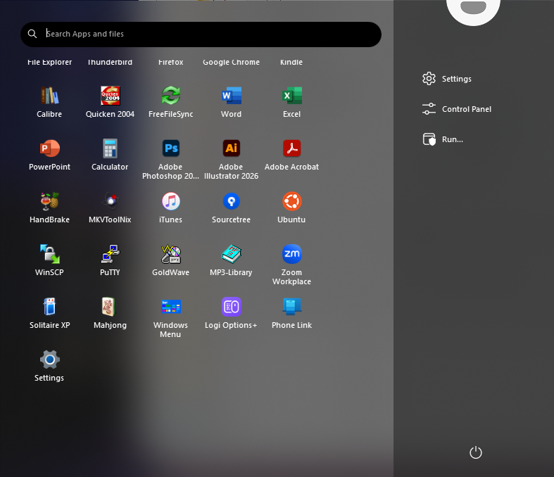

I just updated Star11 to v2.8 and my taskbar and start menu blur and taskbar transparency are gone on Windows 11 Home version 25H2 build 26200.9168.

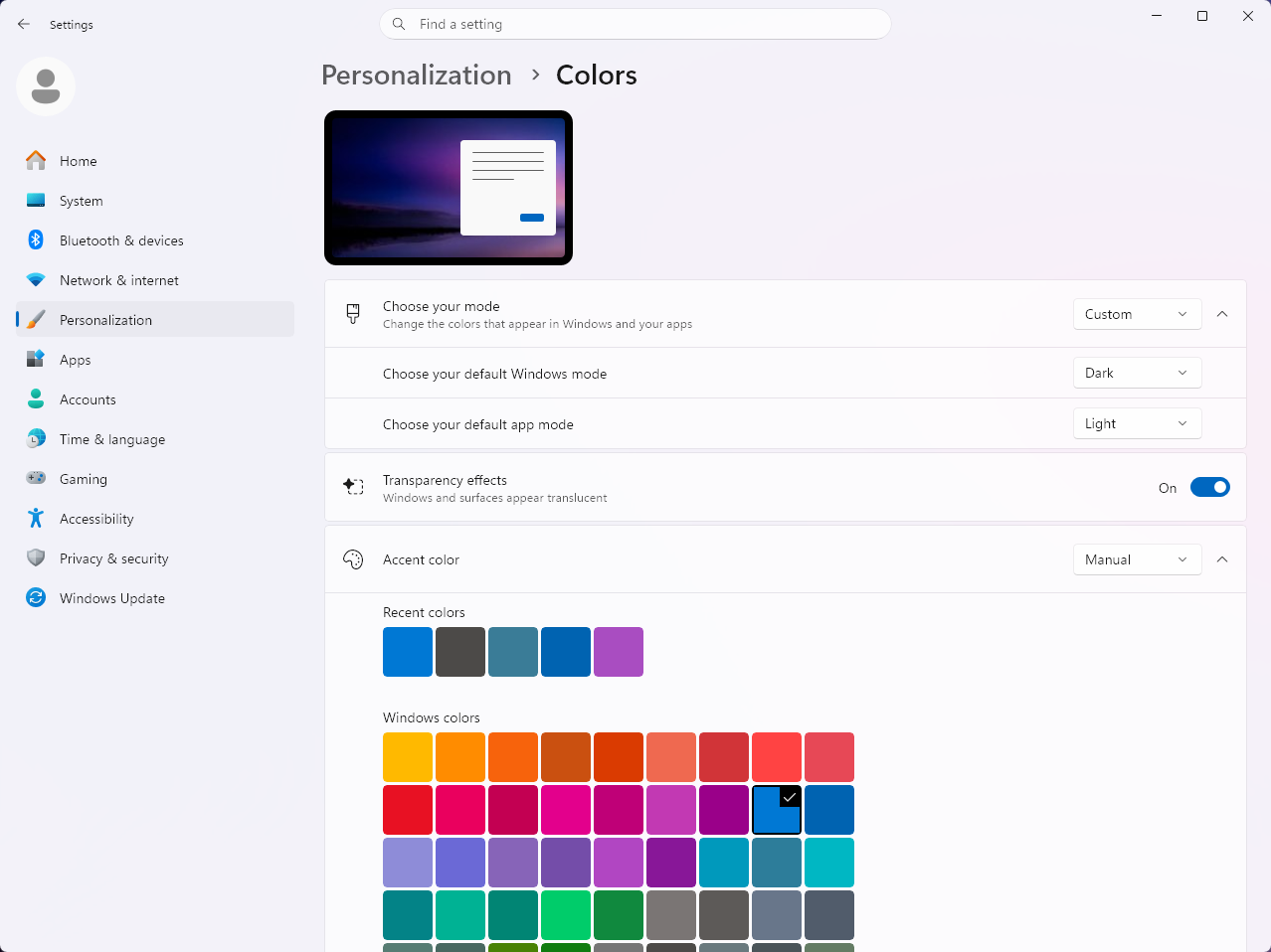

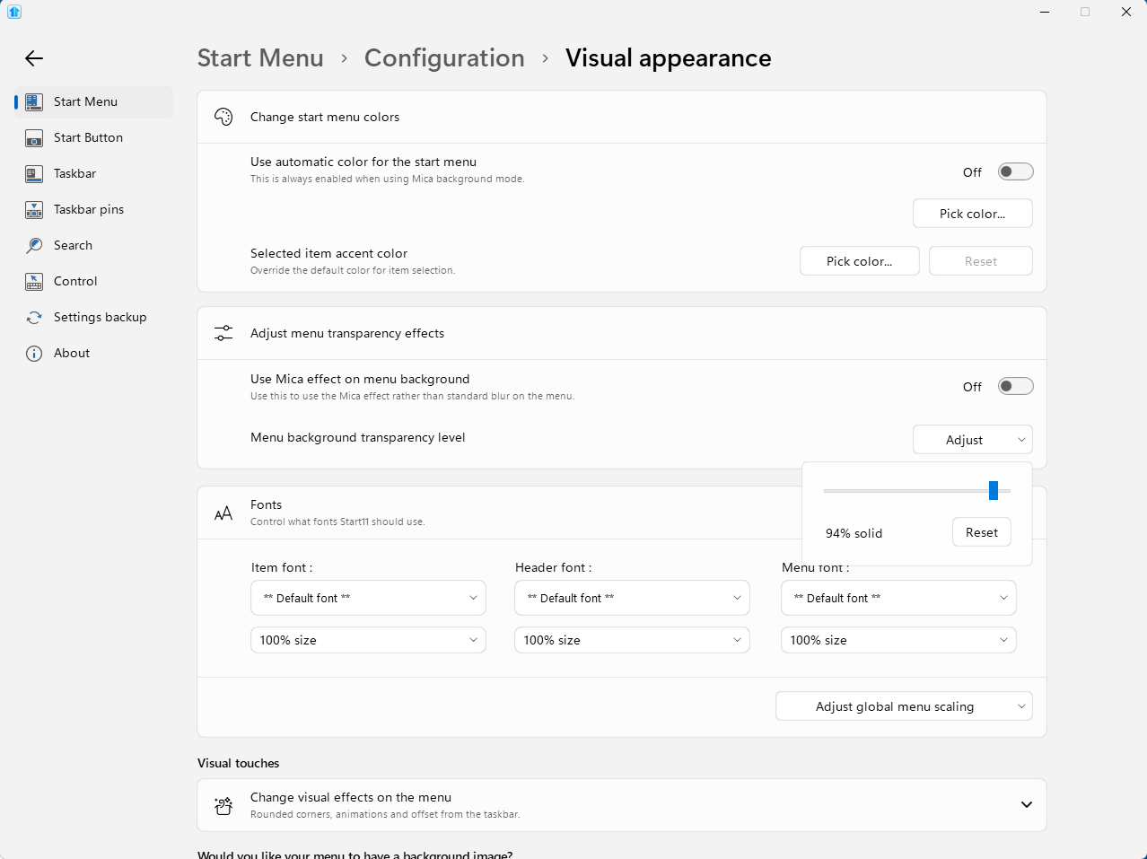

Transparency in Windows settings is enabled. If I toggle it off and back on, taskbar transparency comes back. But when I click Start, and the Start11 start menu opens, transparency goes away. My Start11 transparency setting is 94% (I think that's default) and Mica effect is disabled. I've reset Start11 and restarted the machine several times to no avail.

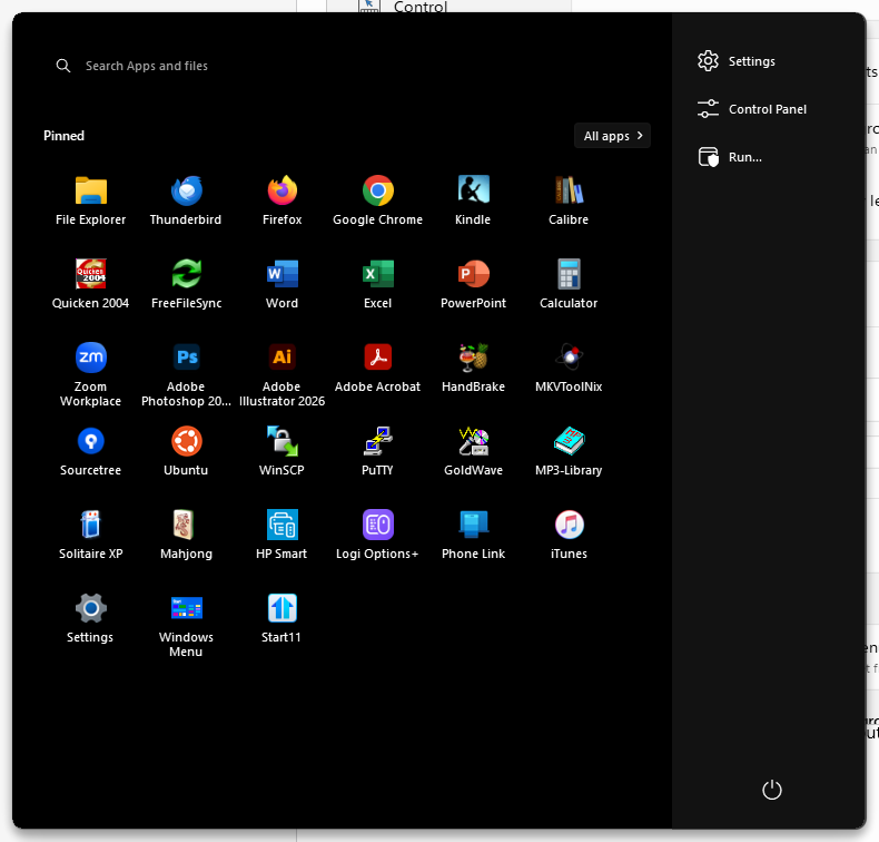

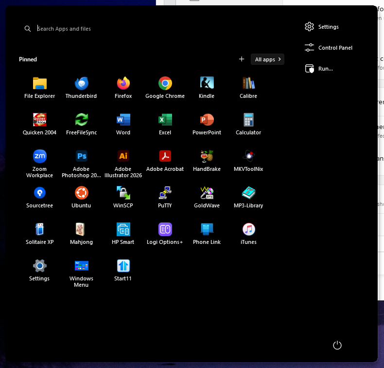

11% is the most transparent and 94% would be almost sold or opaque. Set your transparency lower.
This is what setting it to 11% looks like. As I mentioned, 94% is the default, which is how it was set before.
94% is the default for that slider, so it is worth putting it back where you had it. Our own before and after examples for the menu are both taken at 94%, and what changes between them is the Mica toggle rather than the slider position.
Mica is the option in that same section, and it is the one that controls the material effect behind the menu. Turning it on is the quickest way to tell whether the blur you are missing sits on the Mica path or somewhere else.
The taskbar is a separate pair of controls, under Taskbar and then Taskbar Looks: "Blur the wallpaper under the taskbar" and "Adjust taskbar transparency". The blur one is meant to run alongside the transparency effect, so check both are still set the way you had them before the update.

I usually have automatic color toggled on. (I think that's default?) When I toggle on Mica, automatic color toggles off and turns disabled. Automatic color toggles back on when I toggle off Mica. Neither affect the appearance of the Start11 menu.
When I turn off Windows transparency effects, my taskbar turns transparent, but doesn't blur, even though "Blur the wallpaper under the taskbar" is enabled in Start11. The taskbar goes back to solid as soon as I click the Windows Start button.
