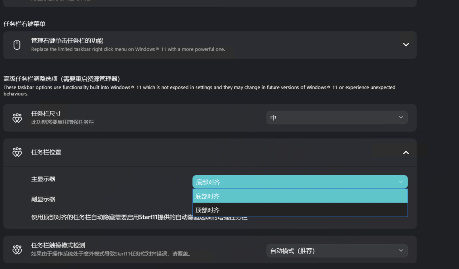

Dual Monitors: Start11 Cannot Pin the Taskbar to the Left or Right Sides
In a multi-monitor setup (Laptop with an external monitor), is it not possible to set the Start11 v2.74 taskbar to the left or right side?
Why, when I connect an external monitor to my laptop, can I only choose to place the taskbar at the top or bottom?
Also, the Start11 settings on the external monitor are grayed out and cannot be selected.

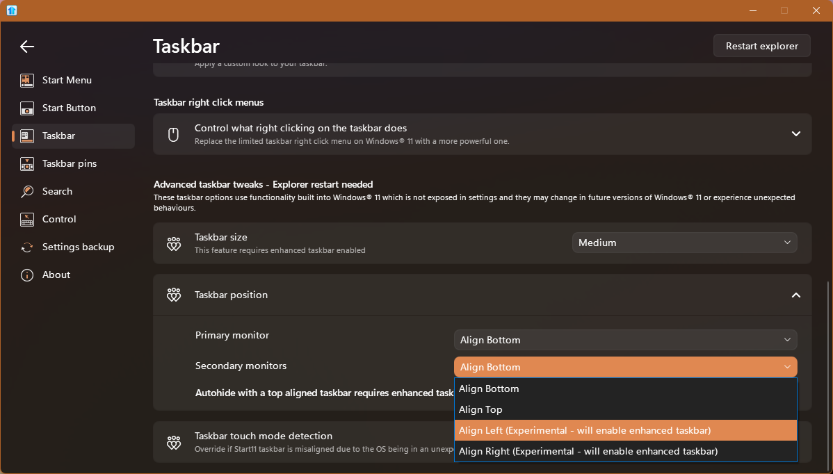

Sorry to hear you are having issues. Perhaps the Start11v2 was not properly installed. Please try, uninstall Start11, reboot immediately (important), download latest version available in your account product download page: https://store.stardock.com/myaccount/products. Install it, reboot immediately again. Retest it and report back.
And you should see this setting.
If you still have issue, please report back with few more details.
