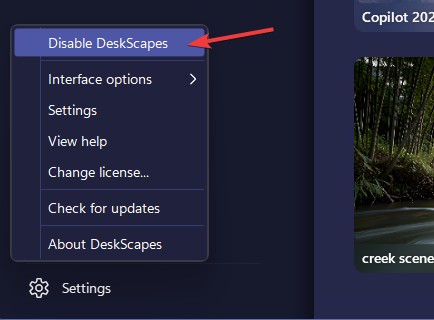

Ok, I was looking at DS 2026 on both my old PC and new PC, and my old PC does still have the "disable deskscapes" button where the settings are, above "interface options." The "disable deskscapes" option is missing entirely on my new PC...
Sorry to hear you are having issues. From what I understand you can always disable Deskscape just by applying any default Windows wallpaper. Right Click on desktop->Personalize->Background->Select background from there. Have you tried these steps?
Also, From what I discover, you will need to apply any deskscape wallpaper to have the "Disable Deskscape" menu item to appear.

On the settings entry basj pointed you at, that is the published off switch and the closest thing 2026 has. I am not going to tell you it does the same thing internally as the old quit button, because I have not confirmed that it does, and there is no documented in-app exit in 2026 that matches the DeskScapes 11 one.
