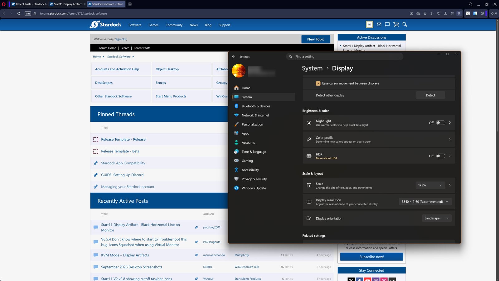

Sorry to hear you are having issues. Need few more details.
  1. Your Windows 11 full version and OS Build number. Use Winver.exe.
  3. Post screenshot of the issue. Since you mentioned that the taskbar should only hide if you have maximized Window or a Window overlapping taskbar.
  4. As a test, temporarily put the scale at 100% and see if the issue appear.
  5. Is the line appear always or after specific time or action on the desktop. Can you step it out so I can try to reproduce it.

Reply #21 Top
windows 25h2  26200.9278
I have the latest start 11.
Reply #22 Top
I cant put it at 100%, that makes windows unusable
no specific time
Reply #23 Top

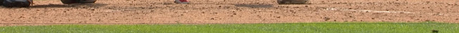

From your screenshot the background there is your wallpaper or a full screen video or picture? I am asking since you said you turn on "Only hide when there is maximized Windows exist?
As a reference this is what I get on my 4K monitor with 175% scale. There is no black line. Refer to my screenshot below.
Screenshot above just as a reference, I am not saying the issue not there for you, just that perhaps, there is something else causing it. Would like to suggest trying Clean boot. Refer here for steps: https://support.stardock.com/space/SHC/1334935592/Start11+Clean+Boot. Do note that Clean boot need to be done with care. Try it and report back.

Reply #24 Top
it was a wallpaper, I would show thew entire screen but the black line disappeared, but i am sure it will be back
