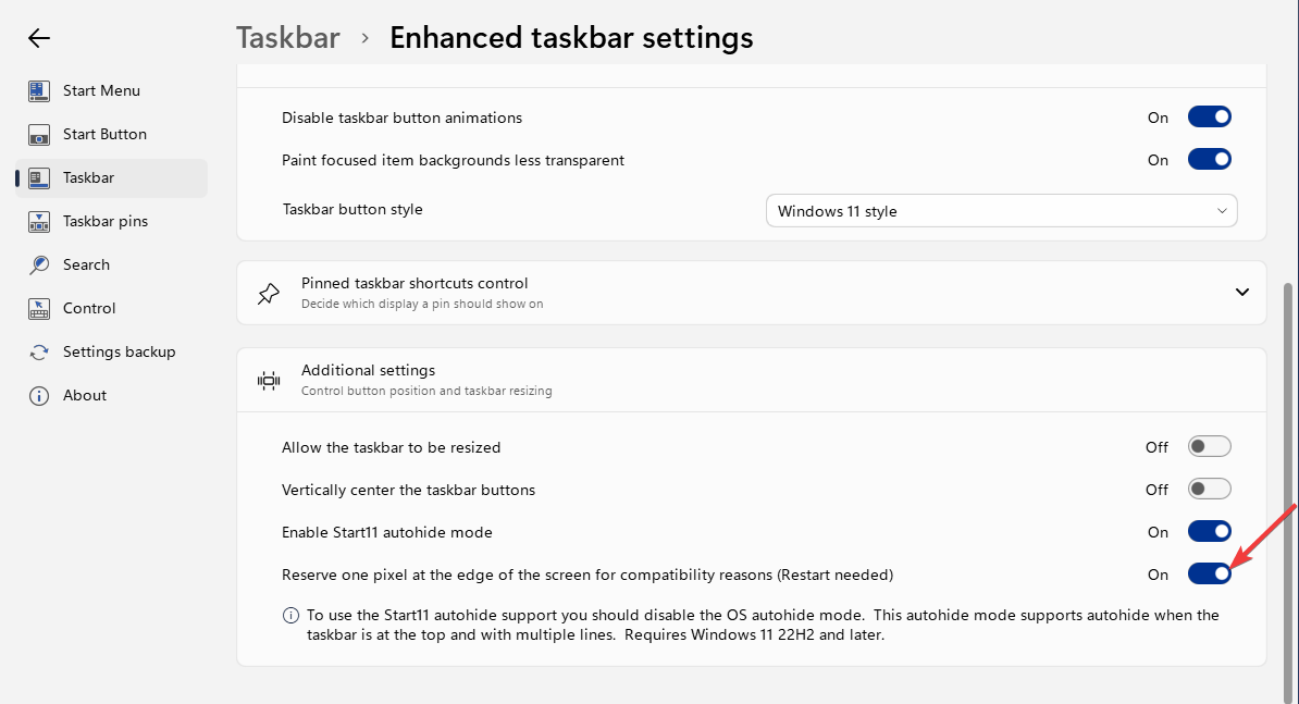

  3. You have turn on auto hide taskbar, yes, please make sure Windows auto hide is disable and turn on Start11 autohide instead and try turn on "Reserved one Pixel at the edge of the screen..."

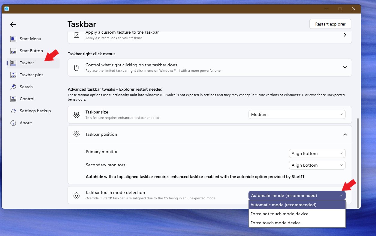

  4. Have you tried different setting in Taskbar touch mode detection? Refer screenshot below.

I've followed your recommendations and have some of the visual elements working, like rounded taskbar corners. However, the functionality to use the taskbar in tablet mode is still not present, no matter which Taskbar touch mode detection setting is used. I've tried a multitude of windows taskbar settings in conjunction with Start11, from everything on to everything off and every possible setting between the two.
Still, there is no appropriate way to bring the taskbar up from being hidden unless I press and hold like a "click" input, and then drag my finger around where the taskbar should be. This is the only thing that prompts it to then appear, which is obviously stupid.
