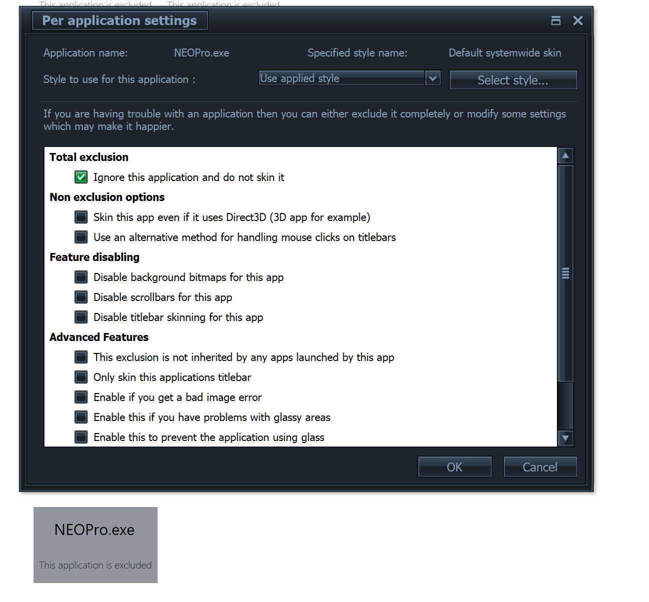

I am using WindowBlinds 10.65 trial version on Windows 10 version 1709. I'm having an issue with Dark Theme on a program where the background is dark grey and the characters difficult to read. I understand this is a skin issue and not a WindowBlinds issue per se, however the reason I'm raising the point here is that adding the program on the per app exclusions list does not change anything. It appears WindowBlinds does not comply with the exclusions list. What am I doing wrong ?  I've added the program to the list and checked "Ignore this application and do not skin it."

If the program is listed on the exclusion list it will only not be skinned, but the color scheme will still be use. As what I understand, color scheme is a system wide thing and can't be disabled on per program basis.
You will need to adjust system wide color using Skinstudio to do that.
